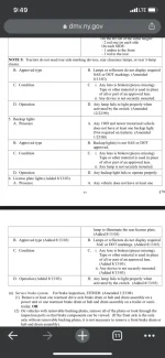

So it has come to my attention that my car inspection expires at the end of October. Having replaced one of the license plate light with a rear camera makes only makes it so 1 license plate light works in the back. I’m curious if I will fail inspection because I only have 1 light

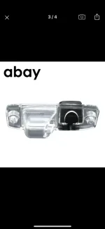

Here is an image of the replacement license plate cover used to mount the camera
So as you can see the area for a replacement bulb won’t fit the festoon bulb.
I looked at the inspection regulation and it says at least 1 light so I’m not too sure just want a second opinion
If it is the case that I need both lights then I’ll have to find another mounting point for the camera probably the license plate as I don’t want to drill any hole on the car
