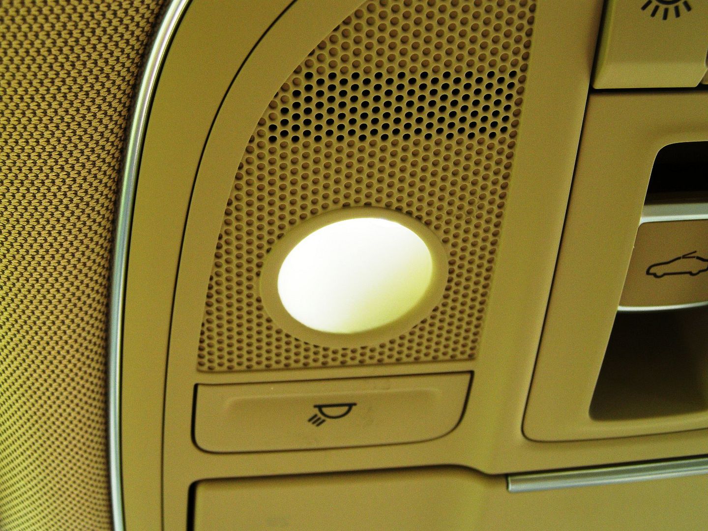

Here is the location of the microphone. The picture actually shows (2) microphones. Not sure if there is actually one located under the right hand side panel or not or whether it is just designed that way for symmetry. One could test this by taping off the left side and trying the phone to see if it works. Maybe someone could try this today & report back...
Here is a picture of in from my car.

Noise cancellation requires two microphones. It subtracts the noise from the one which is located further from the desired source. It entirely makes sense that the passenger is being noise cancelled. So, maybe its the opposite. If you can hear the passenger, then your second mic isn't working! And you dont have noise cancellation at all.
