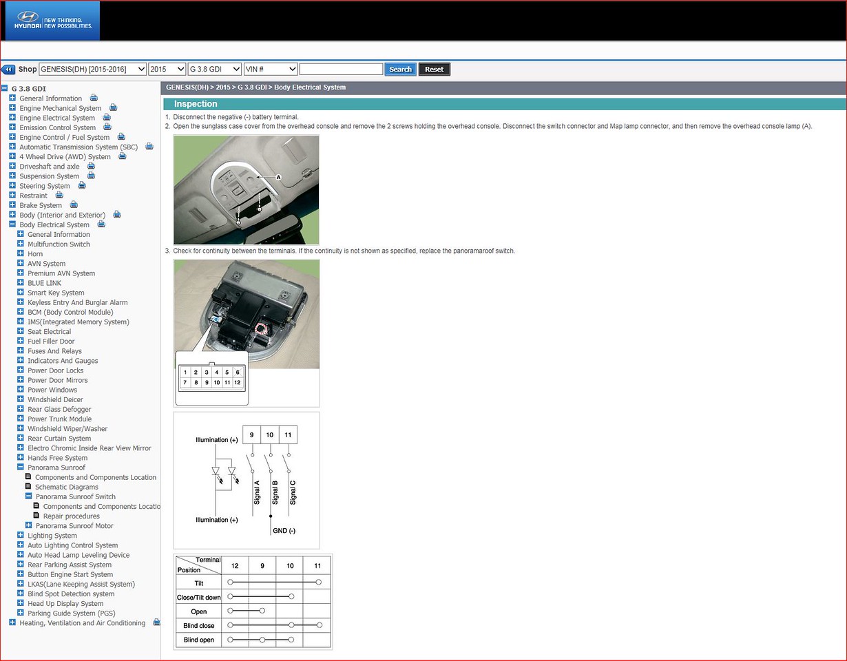

In the meantime, here's the way Hyundai instructs their techs to remove the console:
Thanks! Anxious to see what they say about your rattle. And thanks for posting the pic on removing the lamp console. I removed the screws but wasn't able to pull down the unit. I didn't want to pull any harder for fear of breaking it.
