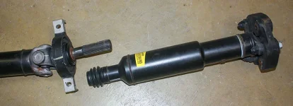

I believe it does have one. I haven't looked under my car, but the vibration does seem to come from that area. Please see attached pic. And anything bearing related would be expected to undergo some thermal expansion as it warms up. Carrier bearing noise was something of an issue on older Genesis models, at least from reading posts on the Gen 1 Genesis threads.
Some driveline specialists say the problem is the bearing, some say it's the U-joint. That used shaft I bought has sagged 1/4" in the rubber mount. The bearing feels fine (30k miles) and the U-joint has light wear. Tempted to flip the bearing support 180 and see what it does.

Thanks for the pic Marky Mark. I can't believe that it actually has a carrier bearing. Yeah thanks for the education, Good pics!
