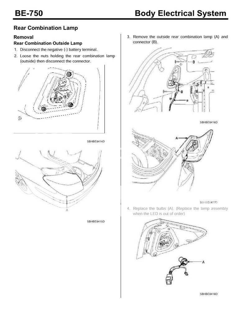

I just went past 100,000 on my 2009 3.8, and have my first issue - though not a big one.
The light on the rear driver side is out and I can't figure out how to replace it. Doesn't look like I can access it easily from the trunk. It looks like an LED from the outside, but not even sure about that.
Any help would be apprecaited
