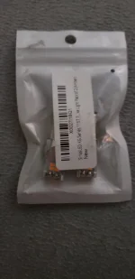

So far my lights have been working great. No resistors and no hyper flash. I believe it's because the LED specs are almost identical to the OEM incandescent bulbs. I posted pics and a link to the Sirius LEDs earlier in the thread, but here is the link again. They are the 1157s, as stated in my signature.

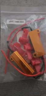

I'm not sure if you installed a resistor or not, but I would think that would solve the problem. I didn't need one, and mine are still working fine, but some have said they needed them. I got mine off Amazon for a couple of bucks. Also, I have the Sirius KG Series 1157 LEDs. The rectangular ones, not the round ones.
