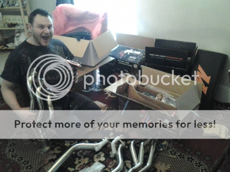

I've ordered the following to not only bring it back to life, but build into a drift project: Mishimoto alum. rad, hoses, & oil cooler kit, AEM CAI, UR water pump & Alt. pulley, Tsudo headers and catless downpipes, Smoked headlights (it has no HL or frnt bumper cover), K-Sport control Pro coilovers, rear slotted brake rotors (had no rotors in rear). I still need to get electric fans, stainless brake lines, and install my hydro e-brake.

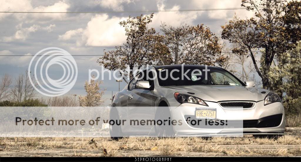

Some pics before she was mine:
And into resurrection
Wifey is even helping out!!!
