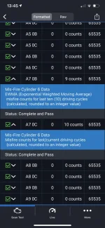

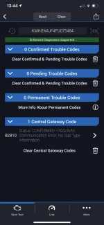

So I tried to look at live data as fast as possible immediately after starting the vehicle (it had been off since 6/29/21 6:50pm up until this point) but I couldn’t catch it in open loop mode… 🤷🏻‍♂️
Idk what “mode 6” is but here are some screen shots of scan and a Dropbox link to a screen recording of the live data.

so like I said no check engine light or any codes pulled from the OBD2 however I was browsing through the mode 6 data and noticed there were 10 misfire counts for cylinder 6. Just pulled cylinder 6 ignition coil and it is brown and has build up. pulled cylinder 2 ignition coil and it still looks brand new. going to swap them and see what happens.

Thanks for the vid. I presume the video starts started shortly after engine startup. Fuel trims settle down to zero at 1 minute... which is very much normal. Anything within a few % of zero is normally just fine.
Yeah a cooked coil could be your rough idle. Coils can be funny with temperature. In the old school days a coil can could work fine when cold then fail when it heated up... just long enough to get you a few miles from home but not to where you needed to be.
I suggest checking the plug as well for any fouling, cracks, etc. as well.
If you were not getting spark intermittently when cold, you would definitely see misfires in the log. And unless the coil cut out completely the CEL probably would not flash. It's a goofy thing with our cars like I mentioned above in post #20. The ECU is doing its best impersonation of Kevin Bacon in Animal House while the city riots around him: "ALL IS WELL!"
If the problem follows the coil, then you have your culprit (or at least one of them). Last resort will be a compression test. A low cylinder might run rough when cold but relatively fine once heated up.

Good news: found loose plug, tightened it, and switched cylinder 6 coil with cylinder 1 coil. No more mode 6 misfire data on any of the cylinders.
Bad news: I don’t think that was the culprit for the rough idle on cold start only but i won’t know until morning. I’m in central Texas and it’s 90°F + pretty much daily now so it takes my car sitting overnight to cool down 😅🤷🏻‍♂️
A loose plug could absolutely have done exactly what you experienced: Low compression rough cold start + dirty coil jacket makes complete sense.
