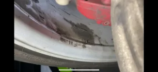

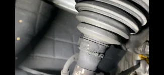

Hate to make this thread, because the car has been great otherwise. At 50,000 miles, I noticed a clamp on my front right axle boot had come loose and let grease go everywhere. After tightening the clamp, 25,000 miles later, I see that it came loose again. Grease everywhere. This time, my car drives like crap and is exhibiting symptoms as if the transmission blew up - not the axle.
I'm now getting occasional jerks under light acceleration at lower speeds, almost as if the car is catching itself. I also get a knocking from the front end when under full acceleration merging onto a highway.

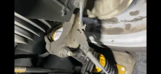

I can't move the axle back and forth any more than usual. Each end of the axle doesn't move when i try to move it. I can move each wheel when it's in the air, but pretty sure that's normal.
The "jerks" are coming from the center of the car. The knocking is coming from the front of the car.
wtf could this be?
All the flex joints on the driveshafts are fine. There are distinct lines of dirt around them though, but i think this is dirt that was flung out from when i drive in wet conditions.
Went to the dealer today.
Well, the knocking sound was a heat shield that a rock had hit and bent to the point where it was hitting some piece in the engine bay. The axle, besides letting all this grease out, is fine. They strongly suggested i flush the fluid at 60k (which i am well beyond) and reset the adaptive transmission learning thing. Gonna get that done next week and see if it fixes the issue. I'm inclined to believe them.
