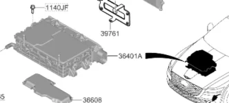

I have the G80 EV and us non-E-GMP'ers have the ICCU mounted under the hood
Does the G80 have the exact same ICCU?
Yup. Part# 36401A
