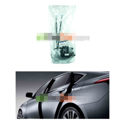

Sorry to Necro, but I really struggled to find an answer to this and wanted to share the efforts of my research.
It does appear that the soft close function can be retrofitted by replacing a few parts. However part of the problem in locating the correct assembly is that in Korea, instead of calling it Soft Closing they call it Ghost Closing.
I managed to find a seller on Ebay named automotiveapple who sells a 24 piece kit so that this function can be retrofitted onto an American car. I'm not sure how long this listing will be up as there's only a few for sale at the moment, but this is the one I bought
The seller was also kind enough to provide me with instructions, which I will also share
Yes the pictures are the newer Genesis G80, but the principle remains the same
