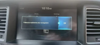

@Gertsy thanks for taking the time to upload the map files but it needs all the contents of the SD Card, specifically the AppUpgrade file. Otherwise the maps won't / can't update.

Sorry, That's everything that's in the root of the Update SD Card. I have to admit I never tried it as they did it in the service. Is yours the Ultimate?
Not a problem. The attached image is what I believe the entire update should look like with the "Bin" folder holding all of the navigation data. Unfortunately, the US updates also upgrade the firmware of the head unit and there's definitely a few differences between the AU/NZ HUs and the US ones. Too risky to try it as it'll probably brick the head unit.
And yes, I've got the Ultimate. The files you provided have been useful - I've found where it sets the HUD to show turn-by-turn but the values are unknown and it's hard to patch. I'll keep looking.

It's really strange. You can put Gertsy's map files on an SD card and put them in the car but it won't load due to licensing. My guess is when the headunit gets updated, some keys are rotated or added. Still not sure if it's running the maps from the AppNavi binary on the SD card or the headunit. I have an idea about slapping newer maps from a different Hyundai update and seeing if it works but I'm not holding my breath.
