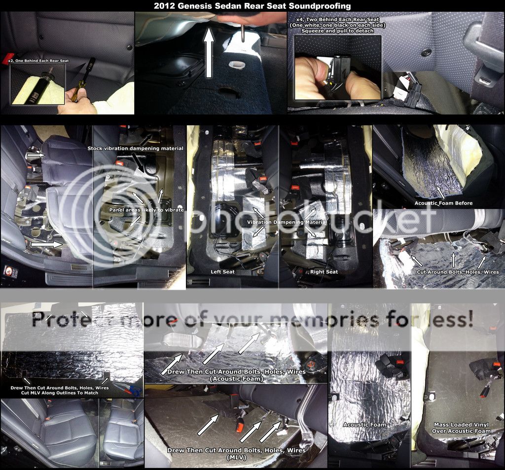

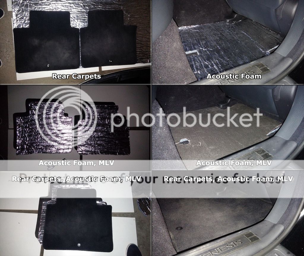

Rear Floor (Removing the floor carpet is a bit harder than in the front as it goes up to the rear seats, but this covers the main areas with less work if you don't want to spend too much time on this)

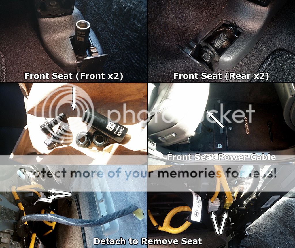

Front Carpet / Seat Removal / Stock and New Soundproofing
(Hyundai did a good job overall with a decoupling layer and MLV, but focused mainly around the middle area above the exhaust and the firewall so the floor was the weakest link)
- I don't have pics of the Pedal removal process but it's one or two screws and then you can pull it up and unplug it.
