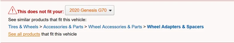

Probably nothing as Amazon gets this kind of thing wrong all the time, but as soon as I visited your link I got this warning (I have my 2020 G70 Sport registered in Amazon):

Probably nothing as Amazon gets this kind of thing wrong all the time, but as soon as I visited your link I got this warning (I have my cars registered in Amazon):

Ya, I saw that too but I found out about these through this forum few people said they use them with no issues plus in the reviews, a lot of them are from g70 owners. Do you have wheel spacers?
