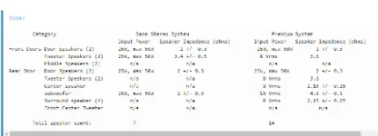

I actually have the technical specs on the two stereo systems, and the speakers in the front and rear doors are identical. (6.5" 25w rms, 50w peak, 2.0 ohms +/- 0.3.)
