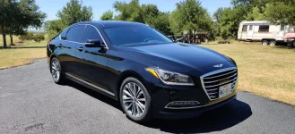

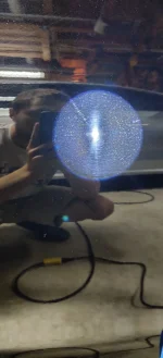

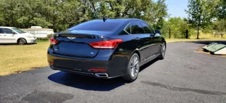

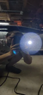

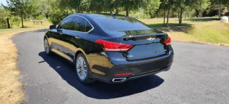

I had the same issues with my paint, before deciding to apply a ceramic coating to it. I spent about 16 hours buffing and polishing the paint. Doing both took all but the worst of swirls and webbing out. It was probably the most work I have ever done on a car of mine, but after putting a ceramic coat on, it cleans super easy and fast and was worth the investment of time.
