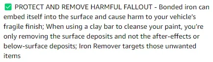

Those deposits are most likely iron oxide fallout from both your brakes and the environment in general (factories, roads, polution, etc.). You need to use a spray-on iron remover like Carpro IronX or Adam's Iron Remover. You spray it on before you wash/clay the car, let it dwell for about 2 minutes (NEVER in sunlight though), and rinse it off; then do the rest of your car cleaning. The spray causes an exothermic reaction with the metal particles, making the edges rounded that are then more easily flushed away with your hose.
I've used several brands and they all work the same way. The reaction emits a sulfur smell, but goes away when you rinse it. Here's a snippet from the item description.
