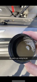

I have had an oil catch can installed on my 5.0 for a few months now. Not much accumulated until recently. I removed it for a dealer service and in the few days removed, the factory hose leaked a lot of oil. My oil level has stayed steady, so I’m not too concerned. Does anyone know what would cause this sudden rise in blowby?
I’m thinking it’s because of the cold temps where I live. I also use the car for a lot of short trips meaning the engine is cold more than most cars.

A lot of condensation in these cold temps, that may be it
IMO you have nothing to worry about.
I installed an OCC at 6K miles on my 2018 G80 3.3T HTRAC after I bought it in Feb 2018 with 5K miles on it. The color of the captured fluid varies from black to brown like picture above. Consistency varies from oily to watery. I typically capture about 0.2 fluid ounces every 5K miles. I check and drain every 2.5K Miles. I could probably safely go 5K miles between drains. Pictures of what my OCC captured can be found in this forum here.
@JEBIV'S hypothesis about cold weather causing OCC fluid to be more brown/watery because of condensation is reasonable.
