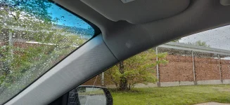

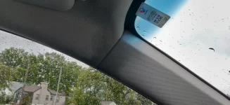

So I'm trying to figure out if this is an issue, or just another weird quirk with a new platform car. I've had 4 cars with sunroofs now, a 96 Audi A6, a 2009 Sonata Limited, a 2011 Sonata Limited, and my 2015 Genesis Ultimate AWD. In every car but the genesis, I could VENT the sunroof while it was raining (it never mattered how hard it was raining), and as long as the car had some forward motion, water wasn't an issue. This weekend, I'm running errands in the rain, and I've got the sunroof vented again. After about 10 minutes, I notice water near the a-pillar seams inside the car. I've attached pictures. I'm inclined to think this means that a vent tube for the sunroof is clogged somewhere, but upon reviewing a parts list for the sunroof assembly, I don't see anything about a drain?!?! So a few questions:

Um. You're crazy if you think sunroof drains are intended to function with the roof open. Or for that matter open the sunroof in the rain at all. That puts water (and associated debris!) places it's never supposed to go in quantities the emergency drains were not designed to handle.
As far as the drains themselves, they run down the A and B pillars. The C pillar has a drain with the panoramic option. Cleaning them is a right nightmare and you should never be introducing dirt like you are.
Then I (and a large portion of car drivers out there after a quick google search) must be crazy. This wasn't some kind of intense, flash-flood kind of rain. This was a rain that caused the automatic wipers to kick on less frequently than the lowest intermittent speed. Hell, here's an entire thread on a BMW board about how a tilted sunroof is ok in the rain. I've always done this, and never had an issue with the Audi (which I owned for more than 10 years), or either of the two other Hyundai automobiles that I've owned. There's no need to be so condescending. Looks like my drains must be clogged (I'm not the original owner of the car), so I guess I'm headed to the dealer.
methinks your tubes are clogged.

The hyundai genesis sunroof is not the strong positive feature of the car . You might be seeing leakeage in drain tube and should see a dealer . Get the compete sunroof checked , and see if you can ask them to lubricate it , there is some white paste they put .
