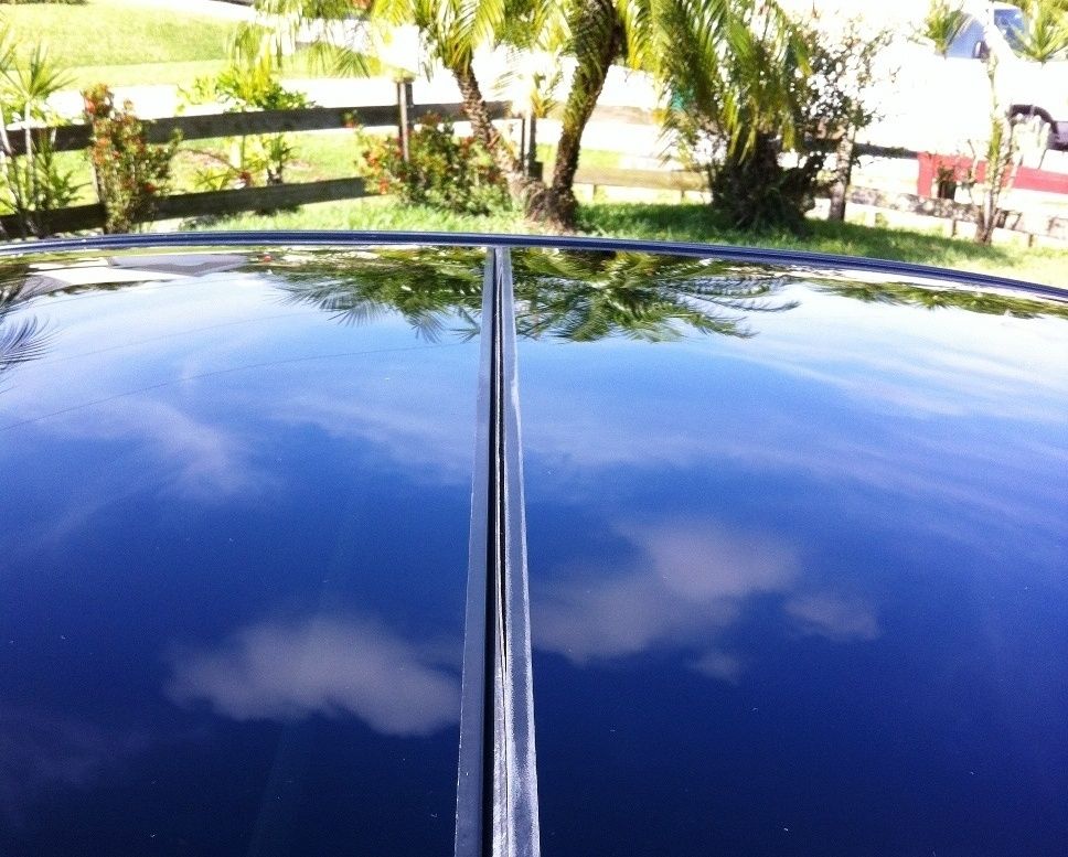

I have only used mine 3-4 times and mine is peeling pretty bad. I don't want to get it repaired until Hyundai has a TSB (Technical Service Bulletin) on how to repair it properly. I have pointed it out to my dealer so they are aware of it. They are also aware of it on the new cars on the lot they have yet to sell. :D
This picture was taken back in April.
