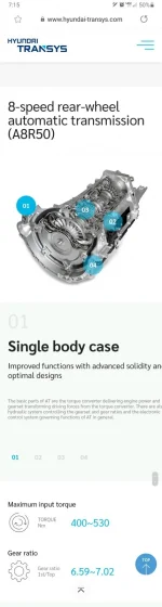

For the initial post about supercharging his 5.0 theres a website which sells transmission parts i think its called level10 transmission they sell some valvebody and transmission upgrades.
it took a while for people to force induct the Lexus ISF, and when the kit was released, its 10-13k for parts...how much do you love your Genesis to pay even 7k for a supercharger...
Not sure if they are still the same people there but many years ago they had a ton of complaints.
