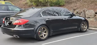

I decide to go with the coilovers from Megan racing. 750 shipped to.my door.
Took 8 hours to install and set up and adjust to my liking.
Cost me about 1k all in all. And I'm pretty happy with the result. My vehicle is lowered slightly and it handles great and the ride quality is still pretty good.
The one complaint I had about the Megan's is the rear coils as adjusted all the way down the vehicle was still stock height. So I had to remove both adjusting collars to get it lower. Which removes any height adjustments.
What I can digest is the spring height and the base where the spring perches are just too tall and they overlooked it
Bit I still like it

Still probably wouldve went with bc if you wanted coils.. but you got new Megan's for the price you wouldve got some used bc. It definitely would have addressed the rear height prob. But looks good nonetheless. Good to know what the dealership price is. Sadd to know they charge 1200 for parts when the actual retail of those parts online is 750 lol
