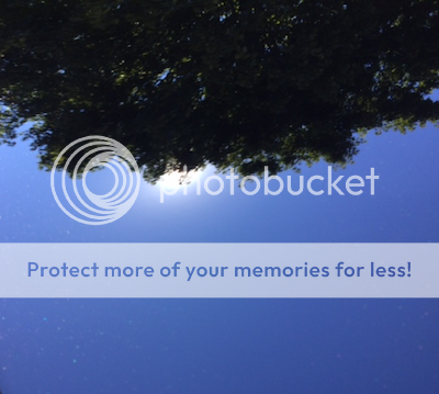

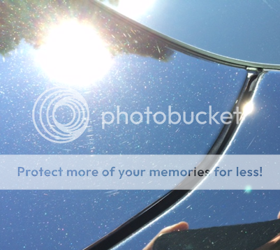

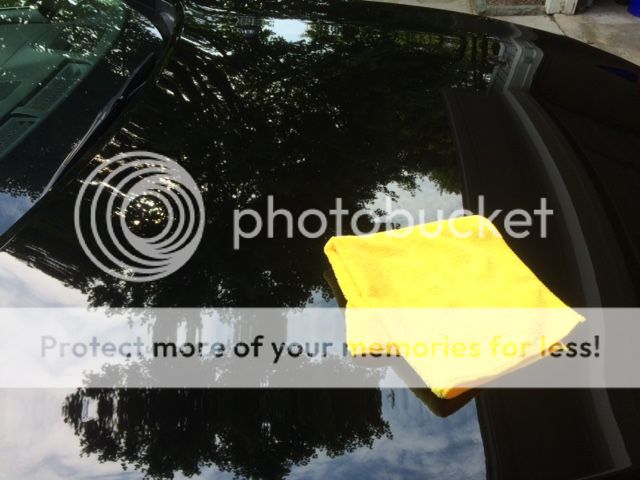

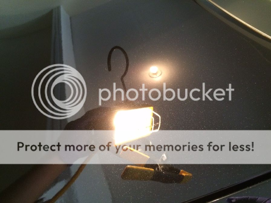

Ok Ksoze, I followed in your footsteps and finally took the time last weekend to work on the car's swirl marks (V6'15 Ultimate AWD Black/Black). My products were a bit different, and I was still left with a few swirls but a huge improvement, I think the swirls left are new (only had a medium grade cutting polish) The main concentration of swirl marks was on the Hood and Trunk, so I only worked on those areas with the Polisher.
Steps:
1. Turtle Wax Rinse Free Car wash (No hose access) dry with microfiber towels.
2. Clay Bar using quick detailer as lubricant.
3. Using Shurhold DA Polisher and Orange Chemical Guys cutting pad applied Checmical Guys v36 Optical grade cutting polish with moderate pressure.
4. Using the DA with the V36 but on a black Griot's finishing pad went over the polished areas from step 3 with light pressure.
5. Applied Chemical Guys JetSeal Sealant (first time using the product- Now love it). Spread a thin coat over entire car with a microfiber applicator pad, waited the directed 20min. and buffed off (easiest product to buff ever).
6. Wait 30 min for JetSeal to Cure
7. Applied Meguiar's Gold Class Carnauba Plus Liquid Wax (left over holiday gift) using a red Griot's pad on the DA, to entire car.
Thank you again Ksoze for the motivation!
Swirl Marks on Hood
Post Polish on Hood
Post Polish Sealant and Wax on Hood
Post Polish Sealant and Wax on Trunk
