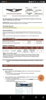

The mystery about transmission hard shift is finally revealed.
Hyundai issued a TSB for HARSH 2~3, 3~4 OR 4~5 UPSHIFT back in November 2021.
The culprits are two solenoids which Hyundai upgraded and they need to be installed instead of the old ones.
The bulletin describes the procedure to replace the 35R and 4&OD solenoids for as shift flare and/or harsh shift during the 2~3, 3~4 or 4~5 upshift.
Attached is the TSB copy which illustrates the part numbers.
Good luck.

My Dealer is claiming that G80's are not covered under this TSB.

The g80 is covered. Here it is:

I did share this with them, they are claiming mine, a 3.3L Sport, isn't covered....
Even if the 3.3L is not explicitly mentioned in the TSB, check with the dealer if the solenoids part numbers (46313-4E701 and 46313-4E601) are the ones currently installed in your transmission'a valve body. And if it is the case, then you'll have to order the new ones (46313-4E702 and 46313-4E602) because the new ones have breathers in them.

I agree it is more of a hit or miss. There could be multiple reasons of a transmission hard shift, to name a few: fluid level or age, valve body, solenoids, pump, torque converter, seals, dampeners etc.
However, Hyundai and Genesis released this TSB as it seems that the vast majority of the victims have been suffering from the hard shifts had their problems fixed with this approach of replacing the solenoids and updating the TCM software. I've done additional research and landed on a Russian forum (where I translated their posts) and the guys were pretty successful in decoding the reason why these solenoids fail. It is heat and temperature. These two solenoids do not have a breather and the new ones do.

I just replaced that two solenoids , everything is fine now
Good luck.

You're welcome. What's the TCM version that was flashed on the TCM?

Did you have the same symptoms of 2-3 and/or 4-5 hard shifts?
What version of TCM software are you running?

Nice update. Good luck. I would still look into the solenoids as they won't produce error codes if the hard shift is due to non electrical solenoid malfunction

Yes ,now it shifting smooth
but there is a strong hesitation especially when accelerating , I'm sure it's ignition coils

Hesitation can be due multiple reasons, voiod be a fuel line / filter / pump or spark plugs or coils.
You may have some debris in the valve body.
