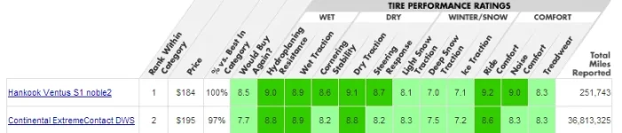

These 2 tires in the first pic shown below are a great option for you for a 19" tire. The 2nd tire is the DWS as you mentioned. Did you see how many miles are reported for reviews on the DWS - Holy Moses:eek:
Otherwise - the next pic is for less performance oriented tires: You can probably pass on the Bridgestones since they don't rate well in snow etc.

Yup, I have the DWS Extreme Contact Contis on my 2011 Genesis. I will get a 2014 R Spec soon (Less than 1 month) and Will get the Pirellis that you listed on your Chart.
The Contis worked perfect this past winter! No trouble at all with the snow and ice. BTW - I took the Bridgestones off ... They were terrible in snow. No traction at all!
