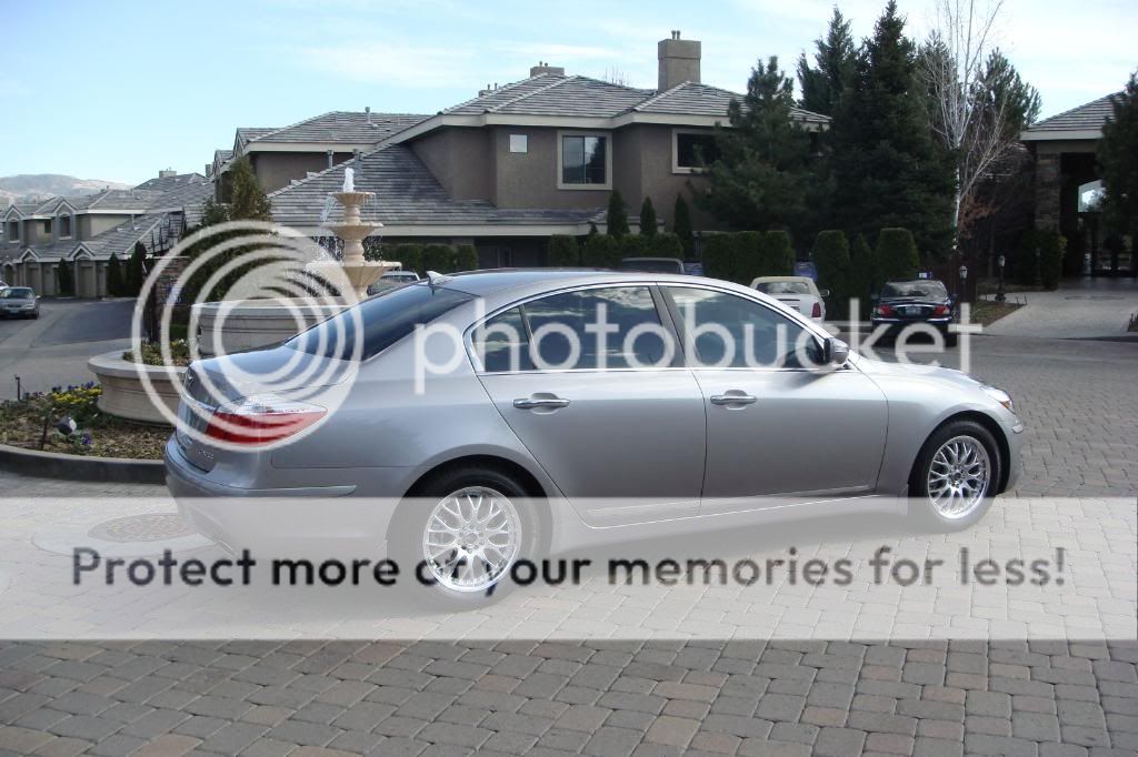

Actually, I screwed up. The picture that i posted was not of a stock 3.8 2009 Genesis. Does anyone have a picture of the 2009 3.8 Stock Wheel?
Here is my 09 Premium package. As far as I know the wheels on my car (17") are the same as the base model.
the v6 has smaller front brake calipers... the v8 comes stock with 18in rims and a lot of 17in rims will not fit..but there are many that will.
