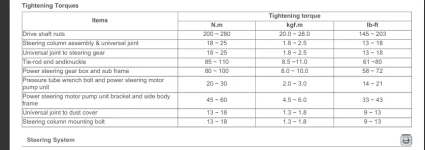

What are the torque tightening specs for Outer Tie Rod ends & lower ball joints for 2011 Hyundai Genesis 3.8L 4 Door Sedan?
2012 4.6 torques below. Pretty sure all cars are the same for the parts mentioned, but I recommend that you verify the service data for your car.
There are two "lower" ball joints. Tension arm and lateral arm.

Thank you, but I've already changed both the front lateral arm & front tension arm about a year ago. I'm clear on those. It's the tie rod end & lower ball joint that I need for a 3.8L. Thank you though.
I couldn't see the attachments before. I see them now thanks.
