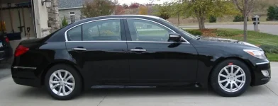

Great choice... I got my Blizzak's mounted last week. I went with the 17" tires and wheels from Tire Rack. The Elbrus wheels were recommended on this very site. Total bill with shipping came $1262.52 plus $53.00 to have the dealer mount and set the TPMS sensors. Have yet to test them in the snow, but I'm hoping for the best!
I always wondered what those Elbrus I02 wheels would have looked like in an actual picture on the car. I didn't care for how they looked on the TireRack website; they look much better in a real picture.

I'm putting on my Enkei wheels and Blizzak WS60s this afternoon for their fourth winter (although I have to check the tread...it might be time to buy new rubber). Viva la Blizzaks!
