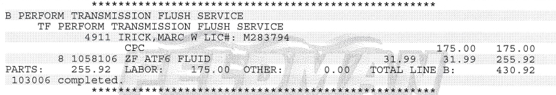

I had transmission flush done in June of 2023. Total for that was $430.
