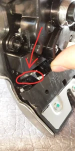

I made 3 cuts in the linear and lifted. Unscrewed latch mechanism, unplugged wires. Lifted trunk and then spent an hour figuring out how to unhook the latch. See attached image. The piece that pushes this guy down had broken off. You need push this down all the way while pulling the entire latch/trunk up to unlatch.

Good to hear you got the trunk open. What a hassle. Do you mind posting a couple more pics of the broken part of the latch? Hard to see exactly what broke. I assume that part of it is plastic?
Some poor engineering/manf on these parts. I received my car with a dead batt and for some reason it wouldn't jump start. I (dumbass, big hurry) didn't realize the keyfob had a 'key' and tried to open the trunk with a broom handle. Got the trunk open but broke the little plastic lever in the hole. Ain't no kidnap victims gettin' out of my trunk.
