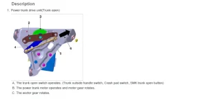

It would be great if someone had a wiring diagram they could share. Hint, hint hint.
I don't have full diagrams.
1692194737191-png.55164
