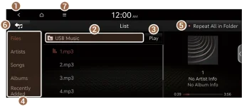

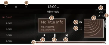

To paraphrase:
... Create a file named "playlist.m3u" in the top level of the drive ... list ... every track with the full path from the top level of the folder... . The [playlist] works in every car I've ever driven that has a USB port that can be used to play music.
I completely agree with your example creating "playlist.m3u". A USB stick with the playlist created with your technique will play on, for example, Windows Media Player as a playlist. Change the back-slashes (\) to forward-slashes {/} and your playlist works properly on Linux or UNIX media players. Technically I think your example is showing "relative paths", from the playlist file to the music file. For this reason the playlist file must be in the root of the USB drive, as you say. So far, so good!
But how did you tell the system to play "playlist.m3u", as opposed to, say, "mylist.m3u"?
Here's why I ask. (And to be as clear as I can, I have attached two pictures from the Genesis Digital Owner's web site showing the USB Music interface screens.) The first, the USB Music image, shows the currently-playing album and artwork, and controls like play/pause, next/previous track, etc. On this screen In the upper right-hand corner is the "List" button, which Genesis describes: "Moves to the file list screen". Attached is a file showing that "List" image too. In the center of that screen is a hierarchical listing of the files and folders found on the USB stick. Along the left edge of this List screen is a way to change the center list to show the Artists, Songs, Albums, and "Recently Added" files. What I do not see is any way to select an arbitrary m3u file.
So again, how do you choose play list "abc.m3u" as opposed to "xyz.m3u"?
I thought tapping "List" on the USB Music screen, then "Files" (on the left edge) of the List screen might show all the m3u files saved in the root of the USB stick. But on my 2022 Genesis G70 2.0 Prestige Edition with 15 speaker premium sound, it doesn't. I can't find any way to show me any m3u files anywhere, in parent or child folders.
Why does this matter? In your example you've created an m3u file to play all the songs on one album. But how about a playlist for "all the number one songs from 1970-1979". Certainly one could hand-create a folder containing each of perhaps 100 MP3s copied from each artist's album folder. But that's tedious. This is the use-case for playlists. And that's why being able to point to a playlist and have Genesis play the song found within matters.
Thanks in advance for any additional info you can add.
Please understand I'm not trying to be a jerk by describing this in such excruciating detail. I'm just not sure the answers so far are helping me "select a play list" as opposed to "create a play list." I need help with the former, not the latter.

I have the exact same problem and, no matter what format of M3U or M3U8 file I use, nothing works.
I've tried changing the coding (ISO-Latin, ASCII, etc.) but it just will not recognize a playlist.
I ended up having to put each playlist in a separate folder, which creates duplicates among some playlists....
]The system has a limit of 8K files, which seems to be in total, versus per folder, so those duplicates means I've had to "tighten my belt" on what music I can put onto the drive....

From everything I have read everywhere, it can't be done. Hyundai did not design their systems to recognize Playlists.
It's blowing my mind that this luxury brand can't do things my 2010 Mercury could do.
