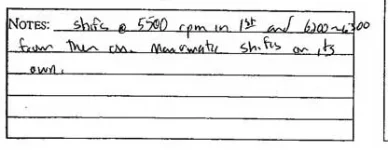

Has someone noticed what happens when you floor it though the 1-2 and 2-3 shifts?
In Manumatic, it stays in the selected gear, even if you lift your foot from the accelerator. If your RPM goes up to the listed RPM limits, yes it will shift to the next higher gear automaticly.
The difference is;
1. Except for when the RPM reaches the upper RPM limit, in Manumatic, the transmission will stay in the selected gear when easing off the accelerator. Only after it reaches the upper RPM limit, will it upshift by itself to the next higher gear, in order to keep the engine from over-revving. It will not downshift by itself unless the RPM drops so low as to cause drivability problems.
2. In Automatic, the transmission will upshift to the highest gear available when easing off the accelerator. Even an upper gear that you really don't want to be in. It will also downshift by itself at lower RPM just as normal automatics do.
This is why people have better control of their cars with a manual or the next best thing of Manumatic transmissions. You are always in the gear you want to be in, not the gear the transmission picks for you, which will always be one of the higher gears.
But the question is does it take the engine to the redline or UPSHIFT automatically at 5500 1-2 and 6200 for 2-3 and the rest? Isn't the power peak 6500 and the redline 6750?
It must upshift at those RPM's automatically, even though in manumatic mode, in order to protect the engine.
Again, the advantage of Manumatic is that EXCEPT at VERY LOW, or VERY HIGH RPM's, the transmission stays in the gear you want it to be in, otherwise, in automatic, the transmission will always upshift to the highest gear available for the RPM. I.E. The gear the ECM/TCM wants the transmission to be in.
What engine speed to the board members see their upshifts occur at in automatic and manual mode? The implication is that the V8 only has around 300hp before it shifts to second, dropping to around 220 or so. And further, in the other gears it shifts before it gets past 330-350hp.
Is that what owners are observing?

Where do those numbers come from?

I did a straight line approximation. 333ft-lb@3300rpm is 221 hp. It may be closer to 360 at 6300rpm. The 1-2 shift drops revs 45% (big gap). 6300rpm would be to 3500, 5500 would be to 3000.
The electronic gauges on modern street cars are fake. That is why BMW says it doesn't use many and why they are so stable. They might as well be warning lights. On a Honda S2000 the tach just lies about the revs after a 1-2 shift, maybe 500rpm too high. At least it says in the VTEC. The ECU actually has a delay which requires a combination of rev and throttle change to drop out of VTEC.
Note that 375hp@6500rpm is 301ft-lb of torque, so the torque curve is pretty flat and the straight line approximation is probably pretty good.
The video seemed to shift way short of the redline in each gear, about 6300, maybe 6200.

If it is being done to limit power, it would explain an early 1-2 shift. However, the video didn't support that statement; C&D may have had a pre-production 2009.
It is common to limit power in first and sometimes second in front wheel drive cars to limit torque steer. However, it is usually done by juggling ignition timing not short shifting, which with the huge 1-2 gap puts you way out of the power band after the shift.
