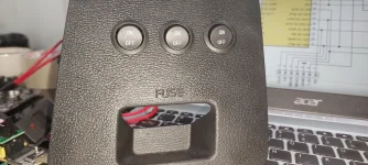

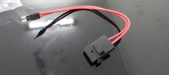

50k Navigation/Radio had a short and was killing my battery/alternator parasite drain. Navigation is done, a replacement would be $3.2k, I'm currently looking for a replacement, may even try putting a mini ipad in the navigation window and having someone do all the wiring.
To fix parstic draw that caused by AVN unit you will have 3 options:
1. Looking for second hand from scrap yard
2. Add toggle switch that's let you to cut off electricity from AVN UNIT
See pictures you need to connect all 10A switch of multimedia, audio1, audio2
3. Connect your AVN unit with rely which cutting the electricity on/off depending on car itself.
