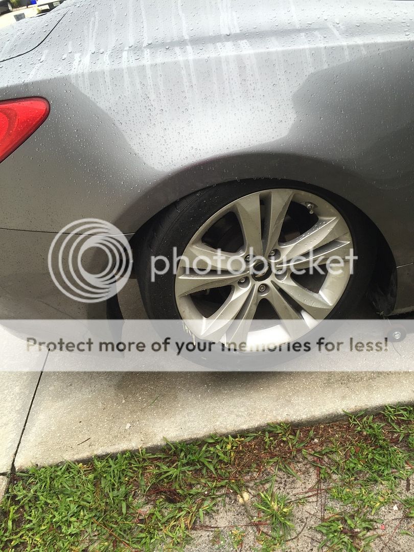

Yesterday I went to pick a friend up and it was raining, the ground and tires were wet, after i pulled out of his neighborhood i made the dumb mistake of hitting the gas too much and I lost control of the car, we spun around and we went over the big grass lane divider and we ended on the other road, thankfully we didn't hit anybody and we weren't hurt. I tried moving the car but i heard scratching, went i went to check i saw that the piece that connects the suspension to the wheel was on the floor, I had to get the car towed and now i want to see what i need to replace because it looks like a couple parts broke including the disc. I also broke my two right rims which i'll need to replace also, I don't want to get insurance involved in this.

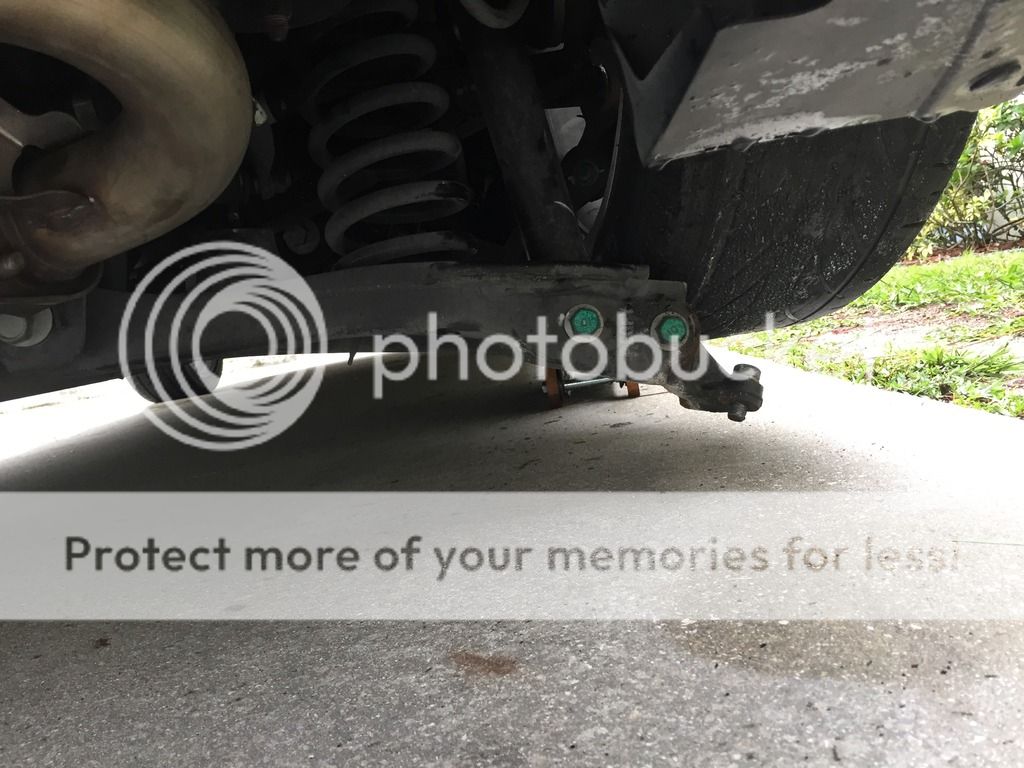

looks like the lower control arm broke along with the rear swaybar maybe? Would need pics on a lift to see whats actually missing/disconnected

Your tire is almost bald, probably part of the reason you crashed.
Ripped lower control arm off the rear hub and most likely taking the stabilizer link for the rear sway with it. Wouldn't be surprised if you damaged/bent the other two rods in the rear. Possibly messed up two bolts that connect shock to the car. More pictures from underneath would also help.

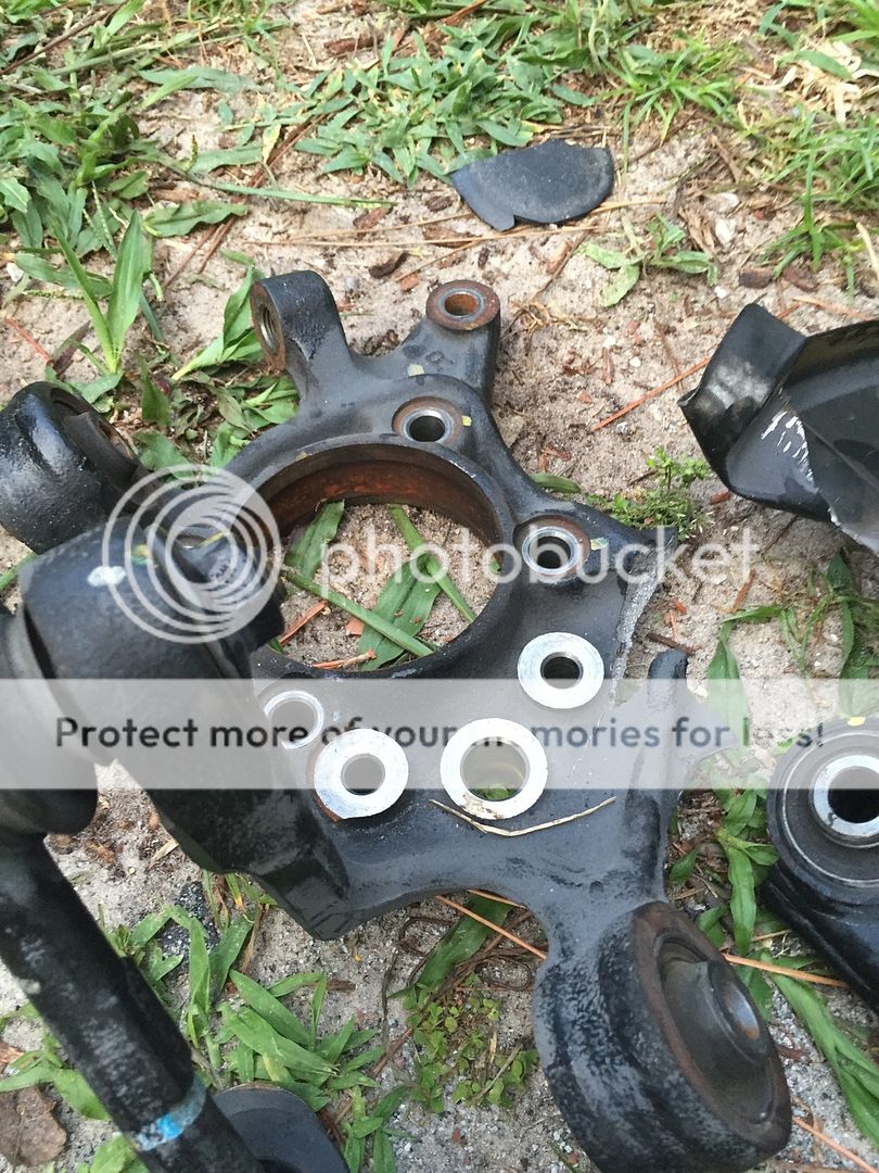

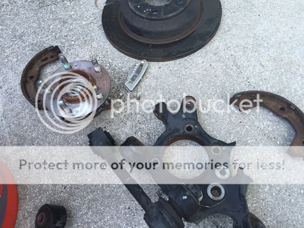

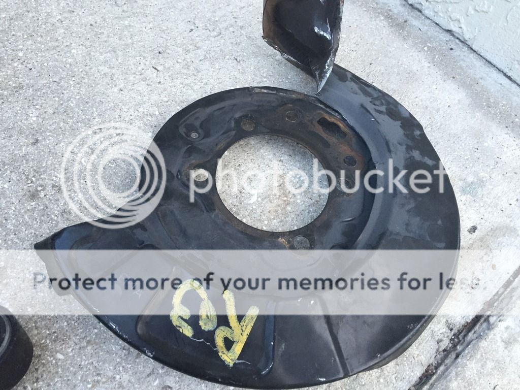

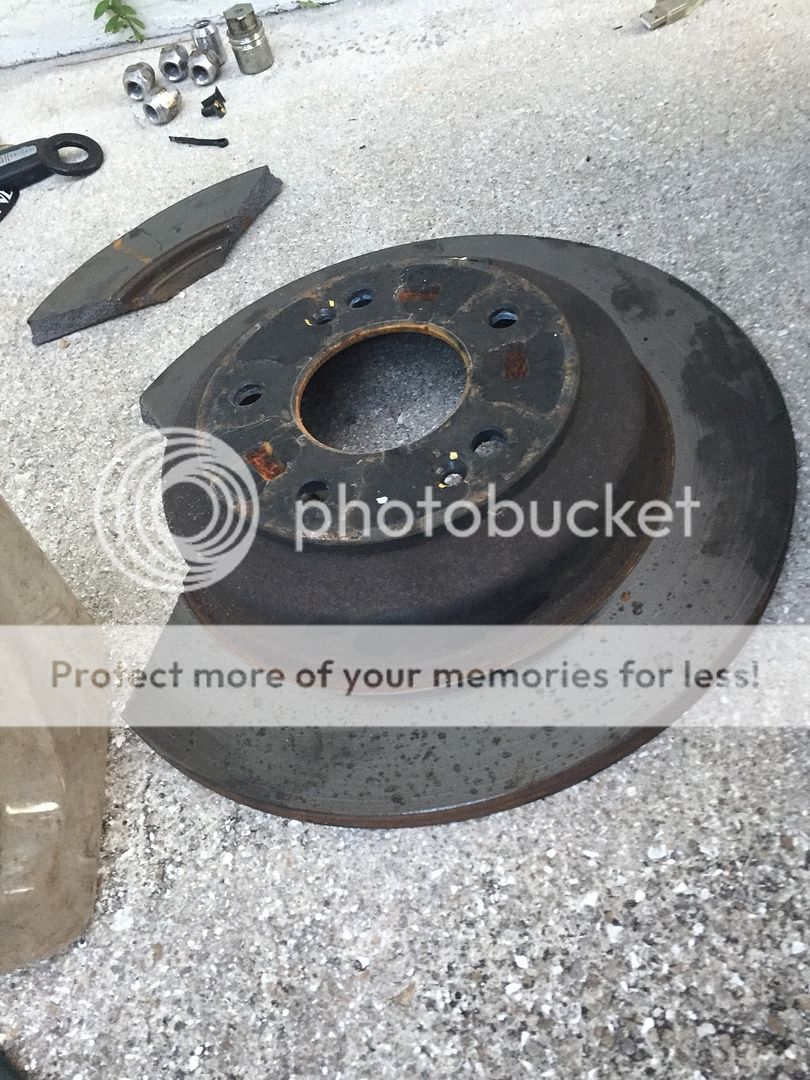

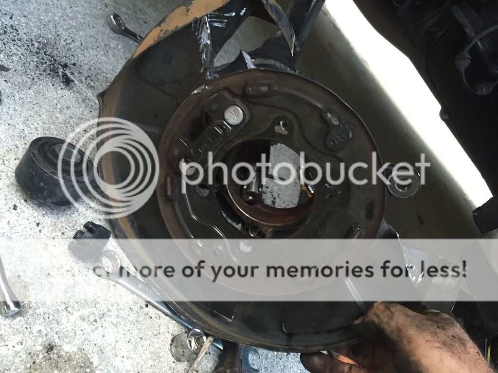

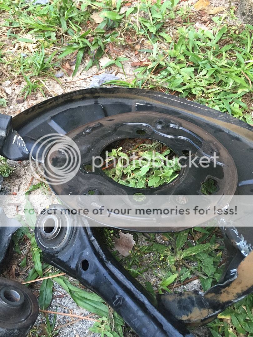

So i took the wheel out today and it doesn't look so bad, the axle looks okay and the assembly, I'm going to have to see if i can find the used parts.
it looks like I need the knuckle, the cover that goes behind it, a new rotor disc and 3 arms, I found a guy with nice 2013 rims so i'll just change all of them and I'll get the new set of tires, i recently changed the front ones so those are good.
Well, in that case, you sound like a hotshot mechanic, so maybe you can do this and keep the cost down, but it's still going be more than your deductible and rate hikes. Still, you have your reasons, so I wish you well :)
Anyway, the rear wheel took quite a whack, so be sure to check the diff and hogshead. Yours is an open LSD, rather than the Torsen, so it's possibly not as tough and may have odd damage.
Wow didn't think the hub was going to be broken. Yeah major impact. What are you going to do with the other suspension arms? Sending you a PM.
I really don't get not filing an insurance claim. There is most likely frame damage and possibly uni-body damage. Good luck to the next owner of this car.
