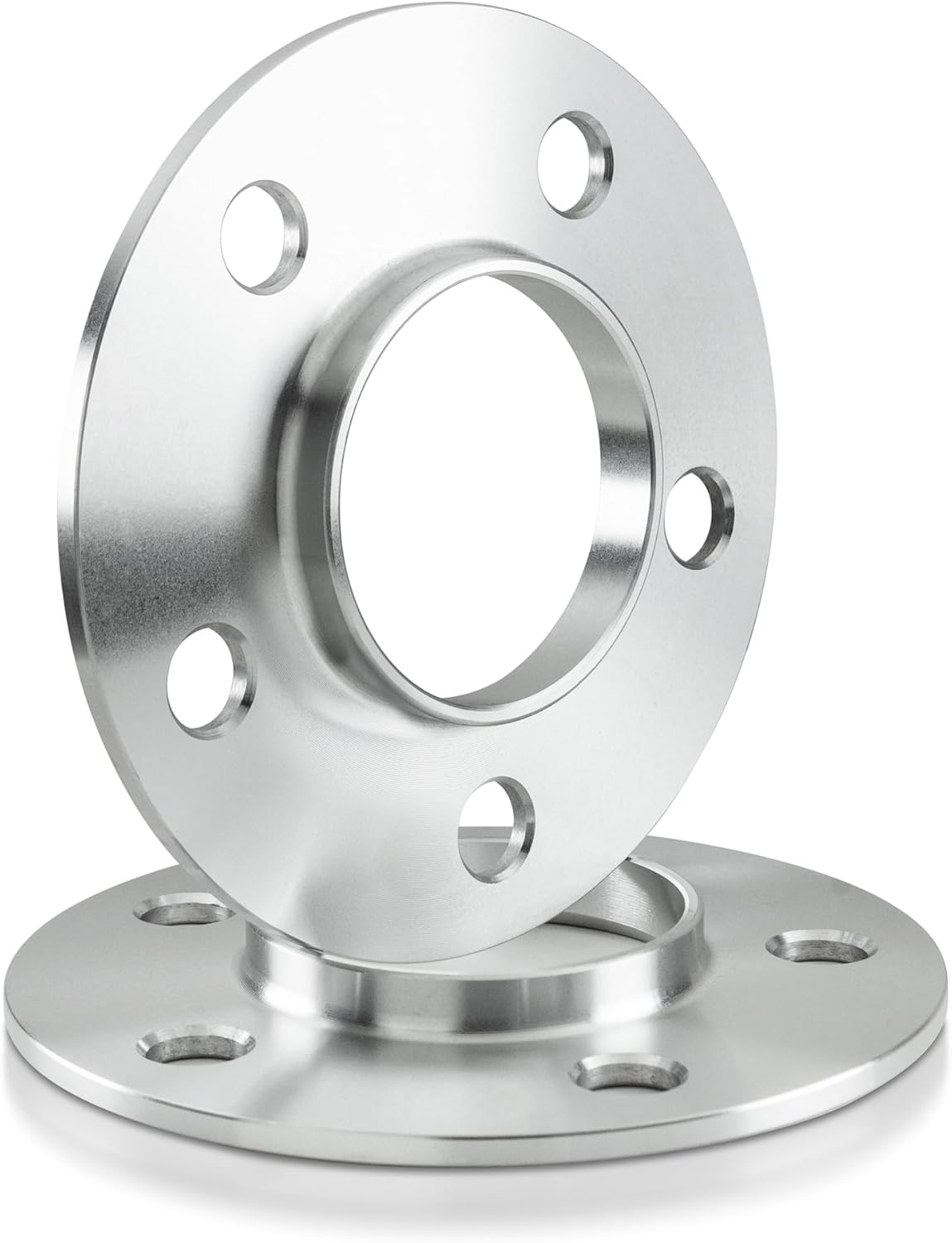

FWIW, you can get hubcentric spacers like these. 3mm and 5mm ones don't require extended studs or nuts. Either would correct your offset to within 1mm of stock 34mm. In everyday driving, an offset deviation less than 5mm isn't going to matter much.
