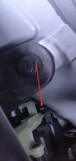

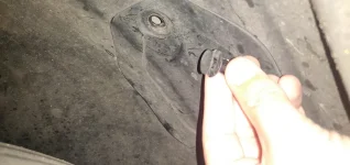

Alright, adjusted mine. Process was pretty dang easy once I figured out how to actually reach the adjustment bolts.
At first I kept trying to find a screwdriver that was both long enough, but also not too thick to be able to fit down the adjustment guide. After finally finding a phillips thin enough, I found that it was actually too thin to be able to grab onto the adjustment teeth. Lol. So, I decided to just get at the bolts with an open ended wrench instead.
Here are the adjustment screw holes/guides...
Here is the Up/Down adjustment bolt....

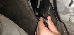

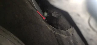

You can get to the bolt through the access panel located in the wheel well. Just pop off the plastic rivet, and pull out the panel...

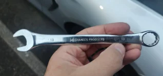

13mm wrench seemed to fit for me.
Loosen (turn counter clockwise) the bolt to raise each headlight beam, tighten (turn clockwise) the bolt to lower the headlight beam. I had to use the open ended side to turn the bolt, and had to flip it back and forth to loosen as there isn't much room to turn it.

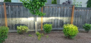

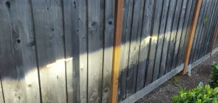

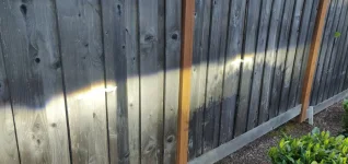

Parked up close to a fence as best I could (and no, the parking spot is not perfectly level, but it doesn't really matter that much), then taped the hot spots in the beam...

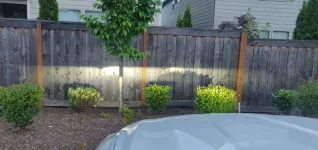

Adjusted to just a little bit higher...
Tested it out and pointed my car's lights at a parked car (Mustang) a ways down the road (a level road), and the lights didn't get up into the windshield at all.
In the end, adjustment was pretty dang easy. Strongly recommend doing this if your headlights are dangerously low like mine, and a few others on this site.
Todd, your post adjustment beam looks pretty high up to me as compared to mine.
Did you do some test drive at night time yet?
The pics taken looks like day time to me.
