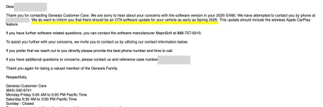

That doesn't sound right. This thread should provide you with the background info you need:
For some reason, the wireless carplay / AA update isn't out for the 2025 GV60 yet. The 25 GV70s and GV80s get it though. I tried downloading the software for a 24, but it didn't work with the car. Sounds like the update is coming out in the spring even though the 25s were included in this announcement. However, it does mention some vehicles being delayed.
I may be mistaken, but I thought there was an OTA for Spring of 2025 that will bring wireless carplay to the 2025 models.
Someone with a 2025 posted to the Reddit forum a while ago with this response from Genesis:
Thanks, this is probably it. It is incredibly annoying (and probably illegal) that Genesis advertises the 2025's as having wireless AA/CarPlay out of the box when they do not...at least preface that it will be available in a future update.
