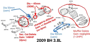

While lifted for brakes change, I noticed exhaust pipes at mid pipe resonator exit are necking in size! 😱 .. While all pipes before and after, measure 50mm .. this portion measured 45mm.
Got them cut and replaced to 50mm pipes 😁.
Eliminating a bottle-neck with %25 more flow area.
When I removed similar bottle-neck of OEM mini resonators (which were in place of sec cats), it got 14whp pump, so this must put a pony or a few gain here or there.
I thought of straight piping the mid section with resonator delete. But when we cut the pipes, saw clearly that mid pipe resonator is all straight through 2" .. so kept it to keep exhaust tone at drone risk free.

Exhaust Re-Cap:
* Primary cat outlet flang bore 46mm.
* Stock exhaust pipes bore 46mm, neck down to 42-43mm in various points (pipe elbows before flex pipes, after mid resonator, and crushed section before mid resonator).
* Sec cat delete a simple & efficient mod, added 14whp & tiny bit of sound.
* Stock mid resonator is a straight through 2way x2".
* Rear muffler delete: swapped to 2" straight through resonators gave it good roar but just a slightly noticiable performance gains, with drone kill by parallel Helmoltz canister.

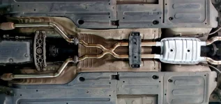

>> Exhaust Re-Worked, from primary cats onward:
- all stainless steel 2" piping, bore 48mm (on average an increase of %12 in flow cross-section)
- X-pipe element in place of sec cat deletes
- kept stock middle section resonator and put back stock rear mufflers.
>> Final Results (combined with intake modification to HKS filter behind a home-made custom heatshield):
- Performance: absolutely feels pulling stronger in all gears, low to high rpm.
- Sound: no drone, quite in crusing low rpm, with a deep louder growel at higher throttle. Just a relative louder than stock (think of an all stock V8 growl).
