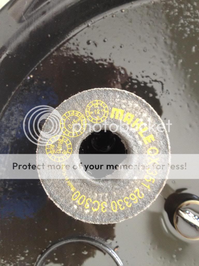

I just changed oil on my 2013 genesis 3.8 V6. When I ordered an oil filter for my car, the dealer sold me a filter with 26330-3C250 part number written on the top of the filter. When I took out the old oil filter, I noticed that it looked little different, it says 26330-3C300 on the top of the filter. I just used 26330-3C250 filter anyways, since the dealer was closed for sundays. Should I be worried at all? Should I change out the 26330-3C250 filter with 26330-3C300 when the dealer opens Monday?
Do they look identical?
As you can see, they are a bit different at the top. But total length and diameter is about the same.
I would take it back and get the correct one. The one you got is for the older V6 with oil filter on top of engine bay.
I already installed it in the car. so I cannot return it anymore. But do you think it is necessary for me to change it with the new one? Or do you think it is okay for me to drive it with the old V6 filter installed on the car?
I think it is OK to drive it for a little while, but I would change it. There is a lot on controversy about whether they are interchangeable, but for warranty purposes, I would not assume that they are.
I guess, I will probably pick up a filter from the dealer tomorrow and change it for a peace of mind. Damn, all the new oil is gonna go to waste....oh well..
