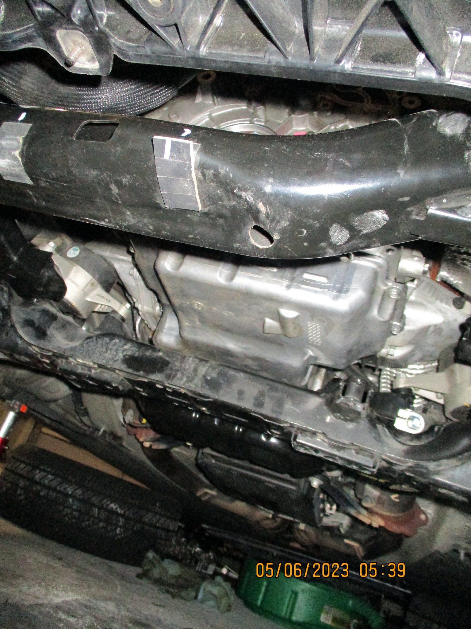

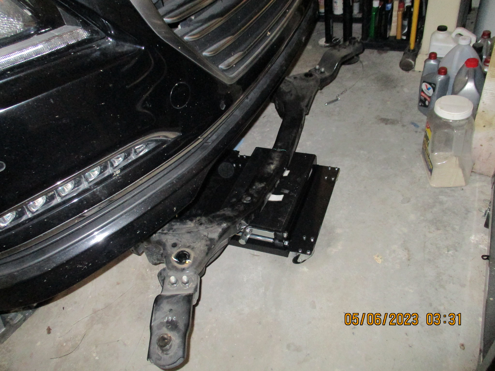

I finished installing the sub-frame. It was pain in the backside to align, but the motorcycle jack dollies worked to get it done. I torqued the sub-frame bolts down to 102 ft/lbs and now I can check the sub-frame off the list. Next will be the suspension and other components that I had to remove to access the sub-frame.
The sub-frame on the dollies; barely made it under the car.
The dollies supporting the sub-frame (and one supporting the engine since I had to remove the jack supports)while I bolt it down.
The sub-frame installed. The hard part of the job is done. Time for the next step in putting my Genesis back together.
Very close now... !
Very close now... !
Yes, the hardest(and most dangerous) part of the project is over.:)
Next, is just trying put all the other smaller components like support brackets,body trim and control arms back on the chassis. It is a puzzle for sure.
Note: For anyone lifting(or supporting) the engine from the bottom; only use the steel lower oil pan with a block of wood. The motor mount side brackets are also a good place to use supports(high lift jack stands) if the sub-frame has to be removed like my in situation.
Never use the cast aluminum upper oil pan itself as a place to lift or support the engine!!!!!

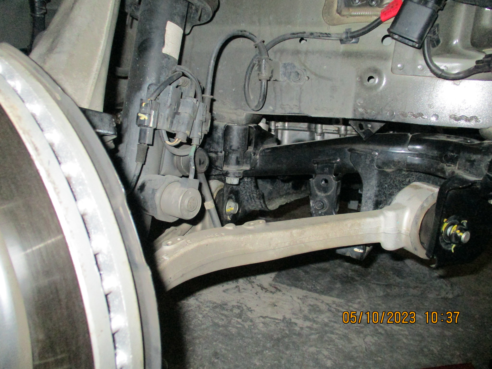

Just an observation: I have to admit that Hyundai did use some high quality suspension parts on the 2015 Genesis. I just figured out how to reinstall the control arms. They is very complicated, but are very beefy.
The rubber grease boots are well made as well. 90k miles and no tears or leaks. I have never heard of the brand name Mobis that makes the control arms, but they seem to be a very good suspension company. Hyundai did not cut corners on the 2015 Genesis chassis or drive-train. Damn well made car.:)
Control arms installed. I would take pictures or have a service manual ready to make sure you can put these back together properly. The control arms are tricky to remove and install. I had to use a couple jacks to help hold up the knuckles while trying to line up the control arms to the mounting holes in the knuckles.

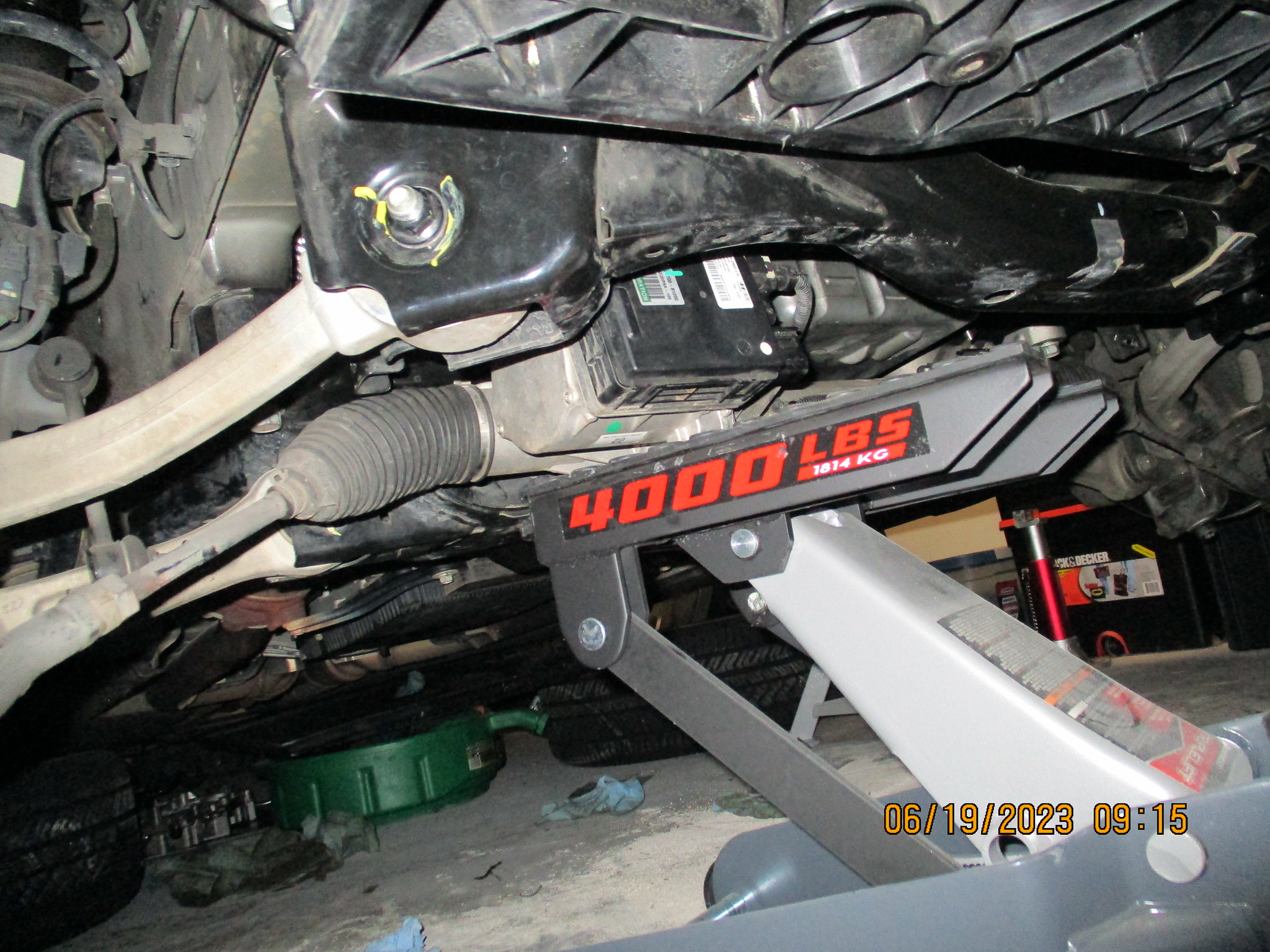

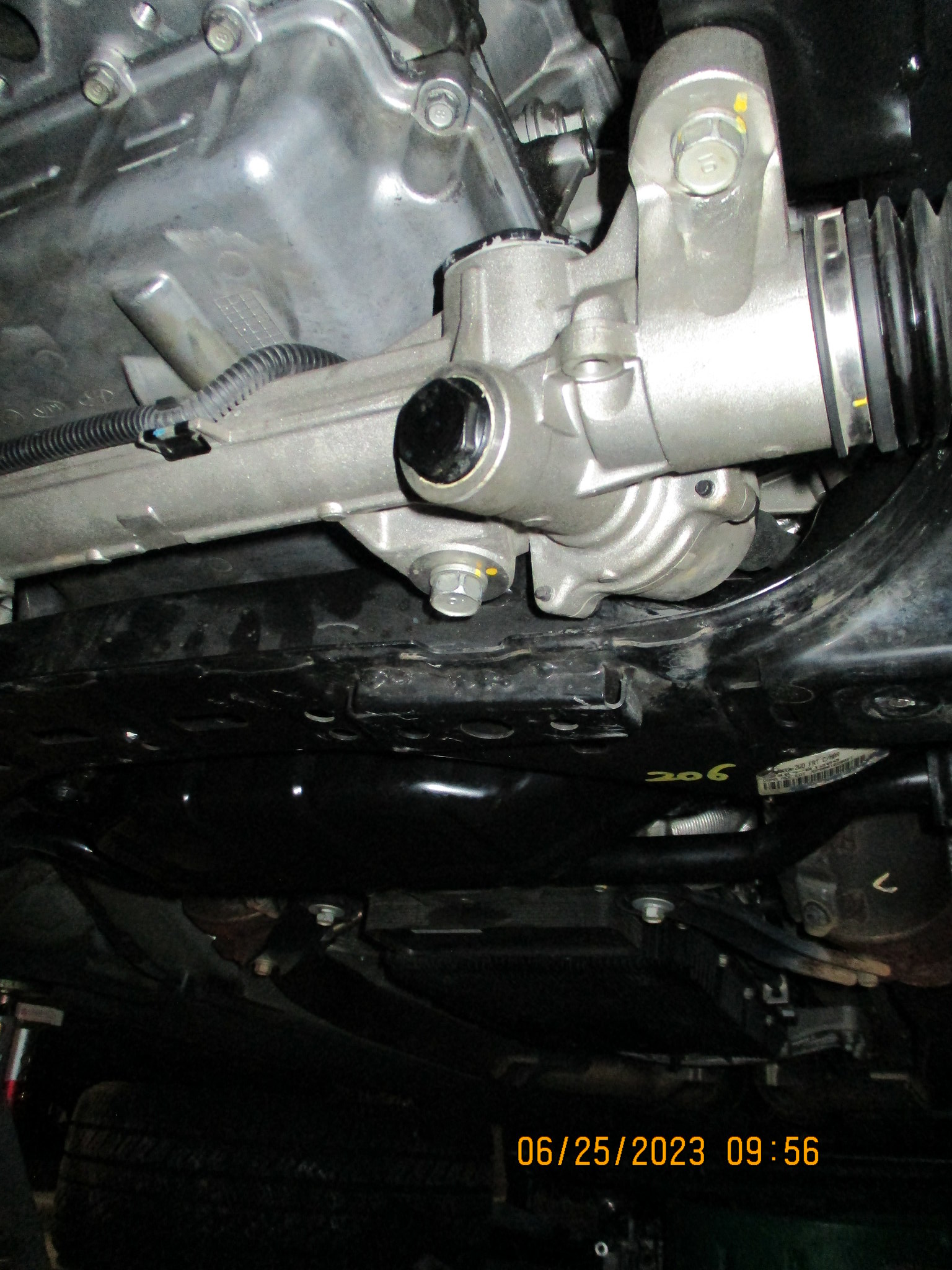

I replaced the steering rack today. I used a wide based jack to help lift and support it while I bolted it back on the sub-frame.
Not many heavy or large components remaining to install on the Genesis. I believe the front sway is the last large part to install.
The steering rack installed with the wide base jack.
The sub-frame and suspension parts are all bolted back on. Now I just have to finish up with the engine oil cooler,AC compressor, alternator, valve covers, etc and the Genesis should be road ready.
