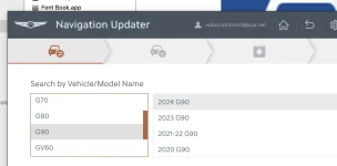

As far as I know it is out for all year model Genesis vehicles. Looking right now, the 2025 G90 is not listed, but it shows the 2024 has a newer software than the 2025 GV80.
Yes, I did look it up and edited my response. Like I said, the 2024 has a newer software version than the 2025 GV80. So, not sure if the 2024 G90 has wireless AA/CP and if you do not, not sure when you would get an update. Next cycle is supposed to be in May 2025.

You can look in your settings to see if one is available to download and install over the air, or you can go to your Genesis owners page on the internet (Not the phone app) and it should be available for downloading to a usb stick and installing yourself. There is some software you need to install on your computer and then follow the step by step instructions. It pretty easy. I am in my 70's had have done it several times for different updates.
I am assuming that your set up your account on the Genesis owners website. If not, you should do that first.

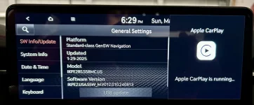

In my G70:
- Press the setup button under the touch screen
- Select “general settings” on the touch screen
- At that point I see the screen in the picture below
In my picture, where you see USB update, which is actually grayed out, you will see it say “Update Available” and it will not be grayed out. I tapped on it and the update started. It took a couple of hours to complete it.
