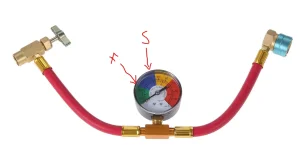

Success! Bought the gauge below with two 8oz cans of R1234 refrigerant. I bought the real deal (Honeywell) instead of the ones found on Amazon which seem to be R1234 compatible. Stumbling my way through figuring out the gauge attachment, I wasted about 1.3oz of refrigerant from the can and at least 1oz from the car itself ( :):( ). At $30 a can, i was not too happy but it is what it is. Funny thing is that the refrigerant in the car measured higher (S) when I started that when I finished (F). I don't get it. The refrigerant was definetely going into the car as there was no leaking/hissing noise. I weighed the cans before i started and i ended up putting in about 8.8oz in the car. Its been a few weeks now and all is well. AC is very cold and no more freeze up and booming blower noise. Driven in 90 degree plus weather for hours and absolutely no issues. For less than $80, I suggest anyone with this problem bite the bullet instead of wasting time with repeated visits to a dealer that probably will not result in a fix anytime soon!

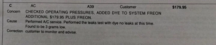

So I took my car into the dealer to have them look at the A/C system. The result was not what I expected. First, I paid for the A/C service. Leak test with dye, but no leaks detected:

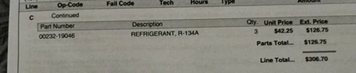

So, of course, they charged me for the 3 grams of refrigerant:
Crazy, right? First, I asked him about the R-134A noted in the description. My service advisor said that was not right, and that they definitely used R-1234yf. He was certain because the ports are different and not interchangeable with R-134A. I buy that. However, $42.25 per gram? It would cost over $26,000 to fill an evacuated system at that cost (see the ALLDATA below). The system holds 630 grams. Even if they meant ounces, it would cost almost $1000 to fill the system at that price (Its $50 for eight ounces of genuine Honeywell R-1234yf refrigerant at auto zone). I can't help but feel that this is an outrageous charge. I have sent an email back to the service advisor today questioning this. So, as the invoice states, I am to "continue to monitor and advise". In other words, let them know if 3 grams of refrigerant corrected the issue. :rolleyes:
Unfortunately, I will not be able to actually drive the car long enough to test for awhile as I am leaving town for a couple weeks starting this Friday.
Interestingly, on my way out I met a fellow waiting for his car at the service department . I heard him speaking with a person there, and gathered he was experiencing the SAME issue. He didn't know what his problem was, just that the fan would be blowing on high, but no air coming out of the vents. I told him I was there for the same issue. He looked at my car and asked what year is it....2018 I told him. The same year as his car.
Here in Florida, where we have high heat and high humidity, this issue will most certainly show itself more often than many other locales. I am beginning to believe this A/C issue is more prevalent than many people think. Consumer Reports (April 2023 edition) lists the climate system as a potential problem in the Genesis G80 years 2017 through 2019.

No, the "gram" is incorrect, but the price is about right. I paid $250 for the refrigerant to have my system filled. An independent shop with material and labor would be $300.
I also had my sytem evacuated and filled with the original refrigerant, plus any needed for $200.
