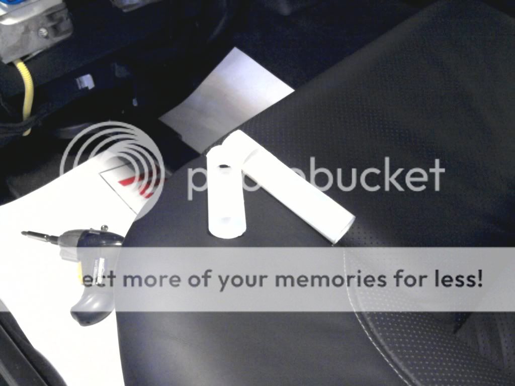

It seams the venting has no physical conduit whatsoever. The conduit is inside the foam cushion. (there's nothing preventing the foam from squishing the conduit. Without going into to much detail, as soon as one presses against the foam, the foam compresses and the conduit (made of foam) gets squished where practically no air circulates any longer.
The fix is EXTREMELY simple and I snapped a couple of pictures with my cell phone...so sorry about the quality of the pics.
This 1st pic is the tubes ( this is semi flexible 3/4" pvc tube)

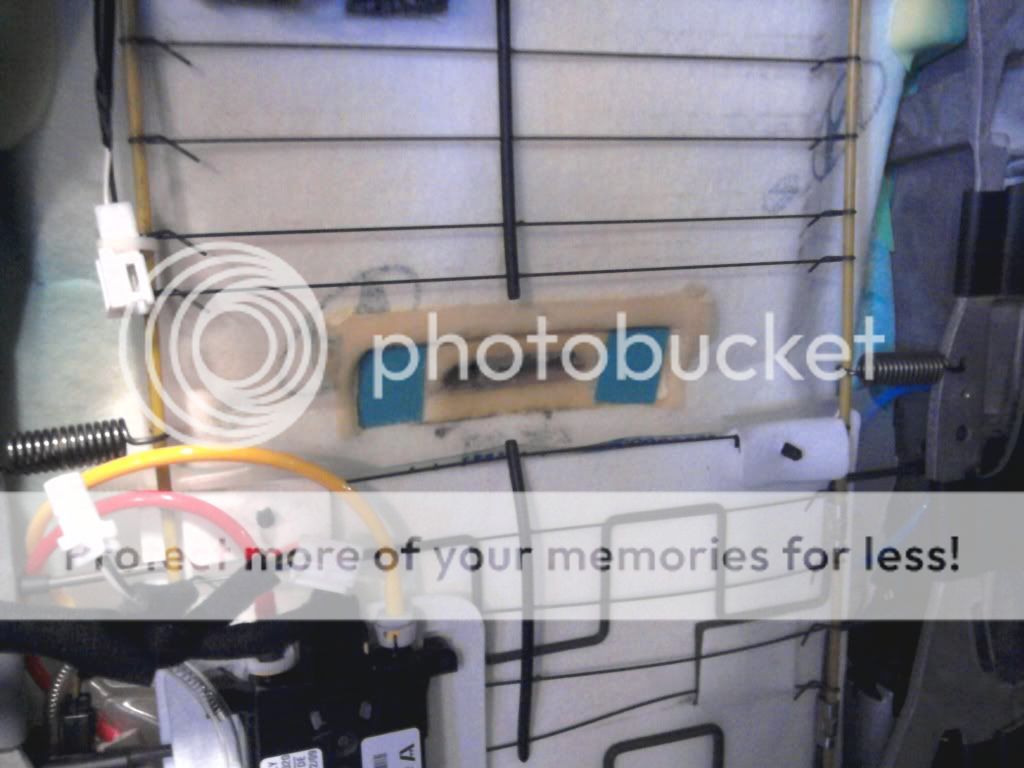

This picture shows the back side where the tubes go. note tube 3 and 2 are exactly the same and that tube 3 is already placed inside the back

Hope you all understand what was done and I can assure you that I don't believe it's EVER been this cold for me.
I am completely amazed how effective it is now and that absolutley nothing was done on the seating portion of the seat.

It is very easy to do...the hardest part was doing the cutout on the PVC tubes.
From there it only takes a few minutes to install.

The 3 tubes are held in place by pressure only.
If I can take the back off the seat, I'll retake high quality pictures and post them up.
Again, nothing was done in the seat portion...this fix is on the back of the seat cushion.
