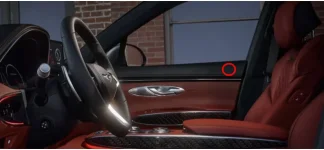

Great detail, that helps a lot, thank you ! I'm certain it's the panel, in both cars if I push where the red circle is, the noise goes away and comes right back when pressure is relieved.
^ You're welcome. 👍 Based on the location of where the noise goes away when pressure is applied on your front passenger door panel, I would recommend you apply foam tape in that area of the door frame as well. I didn't apply any foam tape along the top part of the door frame (below the window glass) in my car, but in retrospect I probably should have. Luckily I eliminated my rattle/noise issue without doing that.
