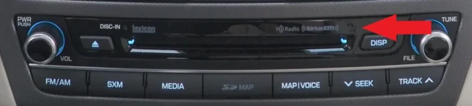

I have total loss of sound at startup about once every other month since new. It also happens more often when I use the Blue Link app to remote start the car. It seems like something just randomly doesn't boot up properly. I always wait for about 15 seconds when I first start my car or after getting into it for the nav to boot up before driving off. If I don't have any sound by then the only way to get it going again is to turn off the car, open the door to shut off the nav screen and to restart the car. The dealer said they would replace the headset and amp if I bring it in while it's not working but from my research all they do is install a refurb unit which may end up having more issues. It's very annoying but seems like it’s just a software issue so I am living with it.
why restart the car, why not use the reset button on the unit itself, which accomplishes the same thing (complete power cycle of the head unit and amp) without having to pull over and turn off the car.
Or if a pen isn't available, just pop the SD card out/in and it will also reset.
didn't know that.. thanks.
I keep a unfolded paperclip in the little tray in the center console for this purpose though, I've had a few CDs get stuck in car players over the years, most have a manual release that requires a paper clip to release the CD.
I can never find a pen as someone always swipes them! I'll try the sd card trick next time;-)
Reset button? Or is that the pinhole thing you mentioned?
on the 9.2" screen (Ultimate and Sport versions of the car I believe) there is a reset button above the CD slot:
