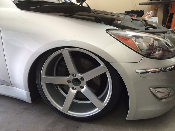

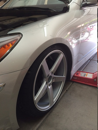

We checked part numbers and they match what is on the BC website. You have no bumping issues? Here's some pics.
BC "default" setting that claimed only 1". Upper control arms hitting fender.

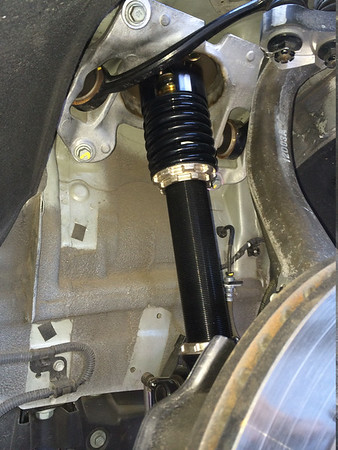

This is as high as we can get it, spring almost fully compressed.
What it looks like underneath. Nice and compressed.

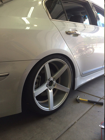

And the rear, which looks damn good.

Did you just drop yours in and was it a 1-1.5" drop? My drop in from the factory was the first pic :eek:

Oh, FYI. So the front was slammed from factory, the rear was straight up Jeep Rubicon 4x4 status. We had to make a major adjustment to the rear. Polar opposites. It was way higher than factory.

All adjustment was made with the correct preload. The springs are fairly compressed with the full weight of the car, which does make me think that the spring rate could be higher.

Either the installers don't know how to install properly or there is a major design flaw in these coilovers. I would like to see pictures from other users who have installed the Megans and/or the BC's without any issues. I have never seen a coil compressed that much before.
