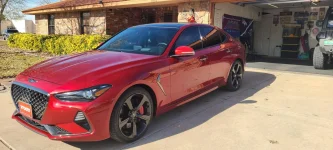

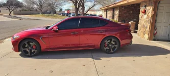

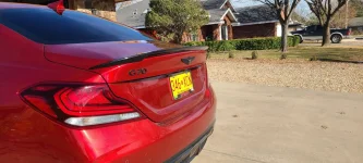

Here's my chrome delete, and just added a spoiler, 15% tint and some black wrap spray paint on the emblems & lettering. I'll probably wrap the little dark chrome strip on the mirrors and the grill frame (not the honeycomb inside area though).

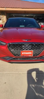

I wish I had a better front pic but I was in a large lot so I took a few.
NOT WASHED WARNING LOL I went home and washed it. Lots of road construction so I normally rinse it off often.

Nice job!
I'm going to paint those oval exhaust rings black next, makes a nice difference for sure!
Nice job!
I had to to do it twice and it totally changes the look like the front. It looks far better.
Take them out, clean good and I put an entire can of Raptor Flat Black.
Reinstall is the most critical part. After a fail in the fry…,
I wrapped them after a few drying days following a ful can hit every few hours.
Make sure you practice reinstall before you paint it’s a bit tricky and it’s tight.
I wrapped them in paper to protect them. I painted them inside and out.
I wrapped them good with tape and once in place took off the paper.
Been over a year, now issues at all. Looks smooth and just flat out better.
