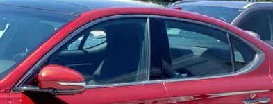

I bought my 2019 3.3T Dynamic a couple of months ago. Got a great deal on a "used" car with only 86 miles on it - $15k discount! A couple of days after getting it home, I pulled it out of the garage to do the first detail and noticed that all of the trim around the windows had this sticky coating. First thought was they had left the shipping protection film on the trim as the car sat for months in the hot south Texas sun. After close inspection, it looked like the dark coating had broken down into this sticky mess. I suspect that this may have been the reason for the deep discount. I used some Goop Gone and a microfiber cloth to remove the mess. All of the trim is now chrome. Given the discussion here, I may contact the dealer to see if the trim can be replaced. Although if everyone is having issues with the replacement, I may opt to leave them as is. I also have spots on the front grill and the "boomerangs". The dark tint was a nice idea, but it looks like the implementation needs a bit more thought!

When I showed up at the dealership to exchange vehicles, I immediately noticed the dark chrome around the driver and passenger doors was all jacked up. I had no previous knowledge of this issue. Needless to say, I was sick to my stomach! I decided to take a few deep breaths, drive the car(which I'd never done), then do a little research via Google. It's what brought me to this forum. I returned to the dealership, showed them what I found online, and asked them to note the issue with the dark chrome on my buyers order. I wanted to cover my butt because it would be my local dealership I'd have to deal with concerning replacement. My local dealer was fantastic, gave me no issue getting the trim replaced, and it looks as good as new. Fingers crossed it stays that way!

Get it taken care of. That's what bumper to bumper warranties are for. This is a known manufacturing issue with the dark chrome and your service advisor should know about it. The dealer I bought my car from wanted to just detail it and buff the stuff out. Took it to another dealer across town in Scottsdale and my service advisor recognized it immediately as a manufacturing issue. Replaced, no questions asked.

Same thing my dealer tried..."cleaning it up." All that did was make it "chrome," lol!
It has started on my 2019 Sport too. Both sides at the rear back seat windows. I'm not sure what my plans are yet. If the problem returns after replaced I don't want to have to keep taking it back in. I briefly entertained wrapping it myself in satin or gloss black but have since decided to leave it as is for now. It may just go back to Genesis like this at lease end.

Mine was like that too. Fortunately their detailer was able to remove and buffed it out most of it.
Hey all, did not see anyone mention a 2020 yet.. Just bought a brand new 42miles 2020 G70 sport with this trim issue two weeks ago. Dealer mentioned the rubbing compound though from what I can see that isnt going to fix the problem. At the same time the chrome tinting on the front bumper is peeling. That's totally different from the window trim which is more of an etching/oxidizing look. The bumper tint is literally peeling off in multiple places.. Crazy.. sent back to dealer today. Will see what happens..
