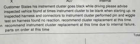

Another quick update here after my second dealership visit for this issue. They just called to let me know that their diagnostic tests returned a "fault" in the results, and they indicated the whole cluster needs to be replaced to solve this. They're ordering it from Korea, and it should arrive within a week or so, at which time they said they'll take a half-day to replace it. I hope this works!

Did they say (or could you ask) what the fault was so that the rest of us with this issue will know what to look for? Thanks!
Mine was already replaced once when I had the" OTA Update Stuck at 63%" issue earlier this year. That was their initial "fix" to the issue before they figured out they could solve it with a firmware update. I suspect same will happen again. I have routine service coming up in another 2k miles. Plan on dealing with it then unless the problem gets worse. Hopefully by then, they'll have a better idea of what's going on.
I arrived after the service center closed, so they didn’t know. The write up is attached here, which is not very helpful either.

Thanks, that report does not sound very definitive as to cause. If it were me I might decide to wait to see if this is a simple firmware fix (at least possible) before letting them take my car apart...and then still having the same issue. Then again, my dash has never gone blank while driving, just at startup a handful of times.
Yeah - I'm skeptical but hopeful. I realize generally this sounds like a software issue. However, I'm in another forum with someone who had their cluster replaced 5 weeks ago - and the problem hasn't reoccurred since the replacement. Crossing fingers.
